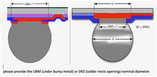

What's the UBM value for TMUX646ZECR? Is it 220um or something else? Thanks!

  • Hi Ysoief,
    I've been in contact with the FAE as well so I believe you may have been update on this already so sorry if I'm just repeating old information but there is no UBM on this device.
    The closest sort of equivalence for a non-UBM would be SRO. We were able to get that value, which is 0.2mm.
    Please let me know if there's any other dimensions or anything you may need.
