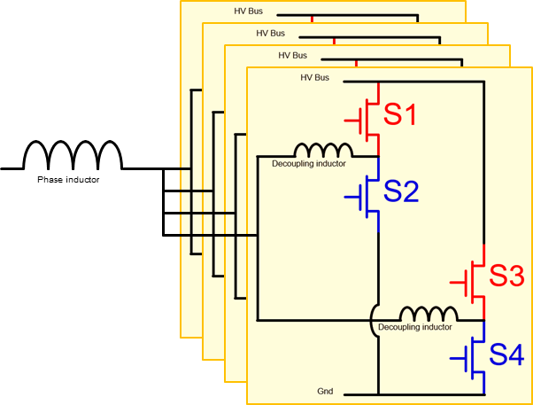

We are considering paralleling up to 4 of the LMG3522R030 or similar GaN devices with integrated drivers.  Is this practicable and if so, are there any special considerations.

    A decoupling inductor is recommended to place at the SW node for hard switching based topology to improve the dynamic state performance. This is based on our lab test for paralleling 2 half-bridges. Decoupling inductors in the range of 1uH can accommodate delays & mismatch at transient condition and reduce switching loss/over-stress on fast turn-on switch. A similar approach can be adopted for paralleling 4 half bridge units.

    You mentioned placing the decoupling inductor at the SW node. Since the switch has both a source and drain, could you specify exactly where the SW node is in this context?
    Our application is a three-phase inverter, and the motor itself provides significant inductance. Given this, would a decoupling inductor still be necessary for our setup? If so, how would its role differ from that in your lab-tested configuration?
    I appreciate your insights and look forward to your recommendations.
  • SW node refers to the switching node, i.e. the point of contact between the source of TOP device and drain of BOTTOM device.
    Please refer to the shown image:
    The motor inductance would add to the phase inductance. A decoupling inductor would still be needed for better current sharing and switching loss distribution between parallel half bridge units.
