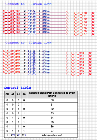

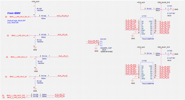

I have a project that requires an 8:1 MUX, primarily for controlling communication between the BMC's UART and eight devices.
The BMC and the eight devices are connected via a SlimSAS cable.
Currently, I am using the TMUX1308, with the circuit as shown below. However, due to the Ron issue of the TMUX1308, I am unsure if it is suitable for use in a UART interface. Please help check.
  • You can use any switch that supports the required voltages and frequencies. UARTs are slow, so you will not have bandwidth problems.
    The TMUX1308 has 59 Ω; this should not matter for slow logic signals. Consider the cheaper SN74LV4051A, or, if you really care about Ron, the TMUX1208.
    (SAS cables are optimized for differential signals.)
