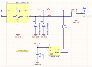

I am trying to design a circuit to control the RS485 bus 120 Ohm termination resistor using 3.3V GPIO from an STM32 MCU. I have never had such an application before.
My RS485 interface works with an isolated 5V supply. When I use TS5A3166DBVR, I think I can enable or disable the RS485 bus 120 Ohm termination resistor directly with GPIO.
Is there something I am missing in the application?
