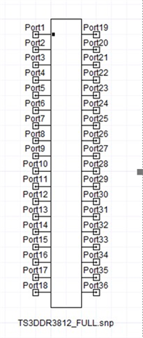

we use the TS3DDR3812RUAR to do the design
need the Snp.file to simlution

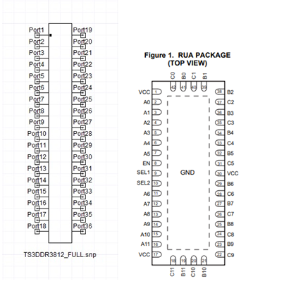

hi Nir
I Saw the previous article, i find the document as below, may i know the pin define?
thanks
Hello Chen,
The pinout can be found in the datasheet of the device.
Nir
Hello Chen,
The pinout I attached is for the TS3DDR3812 device.
I am not sure where you got the pinout you shared, but from what it looks like it only includes the I/O pins of the same device.
The TS3DDR3812 has 36 I/O pins, 3 power and 3 logic.
Nir
HI Nir
left pin 1, is mapping to figure 1 pin 1(VCC)?
left pin 2, is mapping to figure 1 Pin 2(AO)?
We want to know the relationship,thanks
Hello Chen,
Can you please share the snp file you are trying to simulate?
I want to see from where this pinout you are referencing from.
Nir
