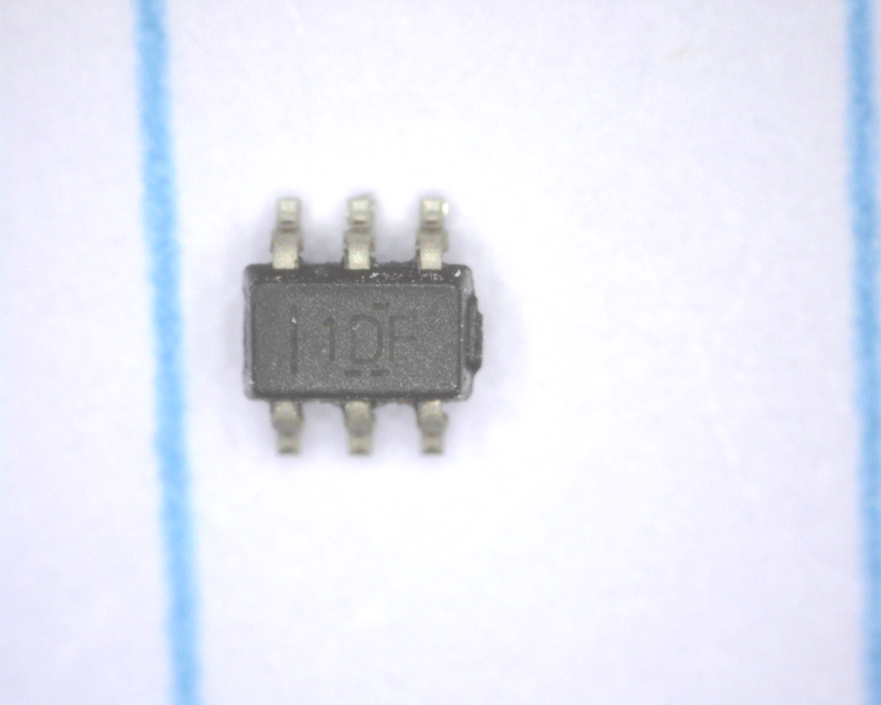

Who is pin 1?
I would have assumed the line is the pin 1 marker. The DVM suggest that this is not correct.
Is the sloped side the pin 1 marker?
Who is pin 1?
I got it from an older opamp datasheet. There does not appear to be official documentation.

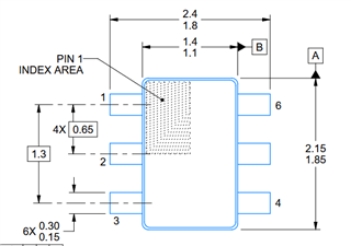

Hi Lawane
I can confirm based of our internal data that Clemens is correct here.
Pin 1 is the top left of this device based on the line.
Please let me know if you have any additional questions
