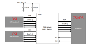

Can the TMUX646 be wired according to the attached diagram? The processor can choose between DSI / CSI, with one port being CSI and the other being DSI
HI TI Teams
Hi Kung,
As long as the frequency and voltages are within the TMUX646 specs it will be fine. It's a passive mux so it acts as a resister with some capacitance when the channel is turned on so what is actually being passed won't matter to the mux (as long as it's within spec)
