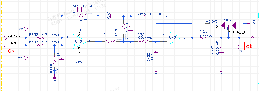

My customer uses TL074 + SN74LV4052 for current sensing. They use two-stage TL074 for current amplification and voltage follower. Then they use all the 8x input channels on SN74LV4052.
Now all the 8x input signals for 4052 is 1.5V DC from TL074 when channel current is 0A. Current level is from -40A to +40A and Accordingly TL074's output is from 0 to 3V.
Issue is that when all the 8x channels have 1.5V DC input. Output signal will have 0V/1.5V and 3V output. Noise will also affect the input signal. There will be a 200mV step on 1.5V input signal.
1. TL074 schematic

I have several doubts:
  • Two SN74LV4052 are put on the bottom of PCB. There are 6 layers. Top, GND, Signal, Signal, Power, Bottom, which means there are no complete ground plane under the SN74LV4052;
  • Is 3.3V power supply for SN74LV4052 suitable for 0 to 3V input signal range;

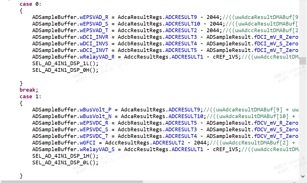

  • Is the issue relevant to software. You can see in last picture. Yellow signal have a 2s period. Could you please share the software control logic for SN74LV4052.
Below are the software setting for SN74LV4052.
From their software engineer, they will switch the 4:1 mux and sampling for 1ch signal in 52us. They need
      • The Sn74LV4052 doesnt have software to control it. It is a analog multiplexers that is controlled by High and Low signals sent to its control pins
        • I mean software control logic rather than software like 1. select channel1 by option pins; 2. open IC enable; 3. ADC sampling; 4. time delay; 5. close IC enable; 6. select channel 2; 7 open IC enable; 8. ADC sampling;
        • Do you have a software control logic guidance? I think it is important to avoid corsstalk.
