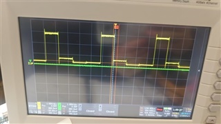

There is crosstalk between channels
Please help analyze and provide suggestions
Hi zhang,
The schematic for the MUX509 looks correct however we might need some more info here to figure out the issue.
1.What is the yellow and green line.( what pins of the device are the connected to?)
2.What frequency are the signals being put through the mux? are they DC or AC?
Please let me know if you can provide any more info and I am happy to help here.
