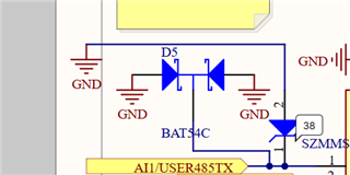

Hello all,
I'm currently implementing the TMUX7236 in a design that should be able to switch between AI/RS485. I would like to protect this line from over/under(negative) voltages as it will be accessible by the user.
What protection do you suggest (the PCB is very populated/not much space)?
