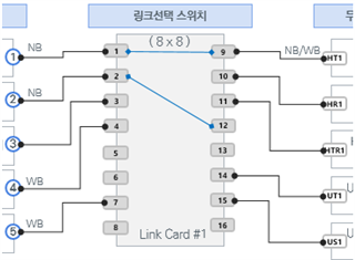

Could you check if LMH6583 is proper for below system?
Usage: link selection switch
EE: land mobile radio
signal: NB or WB
Thanks.

Hi David,
Yes the LMH6583 will allow for pin 9 in your schematic shown to be connected to either NB (pin 1 or pin 2) or WB ( pin 4 or pin 5). Any of the 8 outputs on the LMH device can be connected to any of the 16inputs. Even if you wanted 2 inputs on one output, it will allow it.
