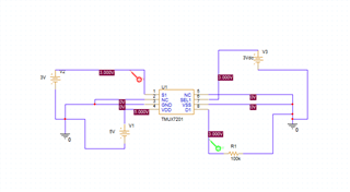

I think the TMUX7201 models are incomplete. When I downloaded the TMUX7201 PSPICE model from TI, I got this error when tried running my simulation:
"The instance `X_U14' is referencing an undefined model or subcircuit, `Delay_SW_S1D1'. Either include the file containing the definition of `Delay_SW_S1D1', or define `Delay_SW_S1D1' before running the simulation."
  • Hi Linh,
    Looking at the model currently online it actually looks to have the  Delay_SW_S1D1
    I also tested the model
    And When I ran the model in pspice it worked
    Can you tell me more about your setup and I can see if I can repeat the failure or just see what you are seeing?
    Kameron

  • Hi Linh,
    After looking into this further your intial thoughts were correct that the model was missing the Delay_SW_S1D1 subckt block.
    This missing text doesn't effect simulations when running this device in pspice but from my teams understanding this could affect other environments you use the model in
    This is the text that I added to this file which should fix the error

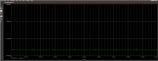

    One issue arose after this though... I tried testing this switch using the exact circuit that you used above in your pspice sim. However instead of reading ~ 3V for the V(R1) mine reads ~ 0V. I am not sure what might be causing this discrepancy?

  • Hi Linh!
    I think the discrepancy is potentially due to myself having a older version of pspice where the TMUX7201 had the incorrect logic control( It was opposite of the datasheet but this issue was fixed in the model released online late last year.
    Could you try to put a logic low signal on the select 1 pin in your design
    This should allow the signal to pass through the switch.
    Please Let me know if this helps.
    Kameron
  • Hi Kameron, I think everything is working as expected now - thank you so much for your patience and support throughout this process!! Much appreciated!
