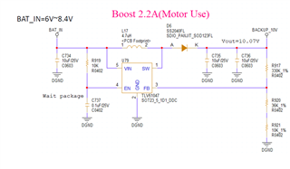

We are designing a circuit using the TLV61047 to drive a 10V motor and would appreciate your help reviewing our schematic for any potential issues.

Hi Tom,
The schematic is OK. We recommend to add a 1uF cap placed near VIN pin as the 10uF cap is for main power. You can see the EVM user guide as reference.
