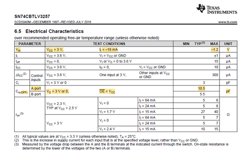

SN74CBTLV3257: Input Capacitance when Mux Enabled
Part Number: SN74CBTLV3257
Other Parts Discussed in Thread: SN74CB3Q3257
Experts,
Can you provide the input capacitance of the SN74CBTLV3257 when the mux is enabled? All I see in the datasheet is when the MUX is not enabled. I am assuming Ci = 3pF, but want to confirm.

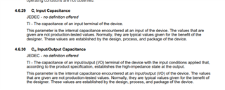

What's the difference between Ci and Cio(off)?
