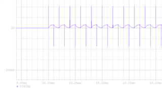

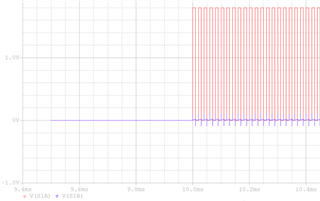

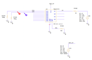

Using the TMUX1574 PSpice model. 1.8Vpp pulse signal was input to D1 as shown above,
and the waveforms of S1A and S1B were taken.
Spike noise about 200mVpp was observed on S1B like cross talk noise.
Is it true or a problem with the PSpice model?
