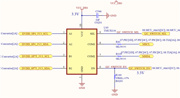

Hi Sir,
Please help to do the schematic review,thanks.
Hello Jericho,
No issues with the schematic, but it seems this mux is being used to pass I2C signals.
Its rated bandwidth is 6.1GHz which is a slight overkill.
Any specific reason why this mux was chosen?
Nir
Size is very small(2mm x 1.5mm) and can suppot 1 to 2
Can it support I2C without any issue,right?
