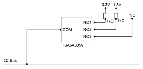

Hi team,
Does TS5A3359 support I3C bus pull-up switching like below?
Or, does TI have any better solution than TS5A3359 for this use case?

  • Hi Kazuki,
    The TS5A3359 is a bit high in capacitance for I3C. The bandwidth would technically cover the 12.5MHz I3C standard but it would violate the 50pF limit on the bus.
    Here are our I3C recommendations:
    (+) [FAQ] What Analog Switch / Multiplexer should I use for I3C applications? - Switches & multiplexers forum - Switches & multiplexers - TI E2E support forums
    The TMUX136 and TMUX121 (not listed in the FAQ) are likely the best options. They're both 2 channels but they're smaller devices so it wouldn't add too much space. The other channel can be left floating.
    Let me know if this works.
    Rami

  • Hi Rami,
    • Looking at Figure 9-7 in the data sheet, the I3C signal is pulled up, is this OK?
      I think I3C will transition to Push-Pull mode when communicating, so I would like to ask if there is no problem by pulling up the Push-Pull type output like this.
    • It also requires dynamic voltage switching between 1.8 V and 3.3 V.
      Is this addressed by connecting TSA5A4624DCKR to the power supply on the I3C Responder?
    Kazuki Itoh
  • Hi Itoh-san,
    I'm going to loop in the translation team to support the question on Figure 9-7 - TXP can you please support?
    Are you using the TS5A4624 now? That device has a 55pF on capacitance, which would exceed the standard recommended max bus capacitance alone. Is the customer aware and okay with going with that device? See my recommendations about for a device with lower capacitance.
    As for how you handle switching between 1.8V and 3.3V, you would need the supply to be 3.3V. If your I3C Responder has a supply of 3.3V then that will work to tie the supplies together
    Rami

  • Hi Tyler, Rami,
    I think there might be a misunderstanding. The response doesn't quite address the question.
    In the customer's system, there is a need to dynamically switch a specific I3C bus between 3.3V and 1.8V at will, which goes beyond a basic level translation requirement.
    • I think I3C will transition to Push-Pull mode when communicating, so I would like to ask if there is no problem by pulling up the Push-Pull type output like this.
    Kazuki Itoh
