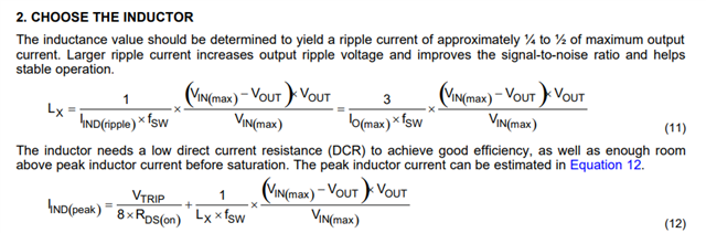

Could you help check the below TPS51219 schematic and any need to adjust
Hi
Hi Gareth,
Schematic looks fine, for inductor calculation only follow the datasheet method.
