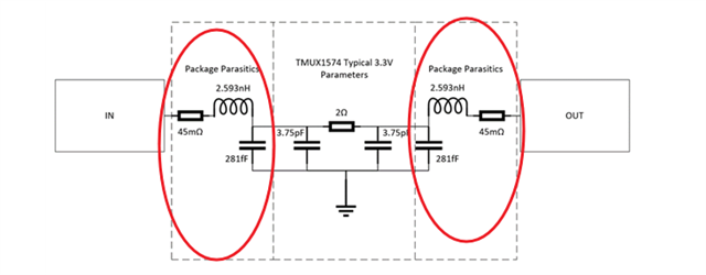

We have a simulation requirement for TMUX646, but we only found the S parameter. Can we provide an ibis model?
Hi Deemo,
There is no IBIS for the TMUX646. Please see our FAQ on what to do if no IBIS exists:
Hi Deemo,
You can use another NFBGA IBIS model to find these. It should be a close approximation.
The TMUX9832 may be the best choice here:
We can also split the CON between the Source and Drain and put 0.75pF on each side of the switch instead of 1.5pF on each.
Technically, it won't be as symmetrical, but for an approximation, it will do
