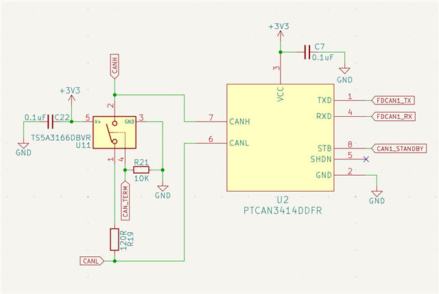

I'm using TS5A3166 to terminate CANbus. Can someone confirm whether below schematic works? I'm using TCAN3414 for FDCAN.
Also does TS5A3166 need decoupling caps?
Thank you.
  • Hi Saero,
    The schematic looks good to me. As long as the signals are within the datasheet specifications.
    Regarding the TS5A3166 decoupling capacitors: The need for decoupling capacitors with the TS5A3166 is application dependent. While this analog switch doesn't inherently require dedicated decoupling capacitors for basic operation, they may be beneficial in certain scenarios such as in electrically noisy environments.
