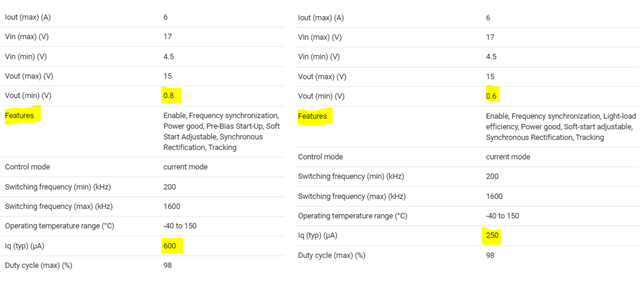

Our Customer is having question related to part below:
TPS54620RHLR
Per End Customer:
Need to contact supplier to check what is the difference between the
series 54620 and 54623 for the below part.
    Some differences for TPS54620 and TPS54623:
    Both devices come from same family so lots of similarities, like same vin + temp + fsw range, control mode, FETs, current rating, VQFN package.
    Some differences are Vref, and 2 new features included on TPS54623:
    - Light Load Efficient With Pulse Skip feature -> good if customer cares for light load
    - Hiccup mode during OC condition -> helps to reduce the device power dissipation
    We do have newer device like TPS543X20 they can look at to, comes in 3A, 6A, 8A.
