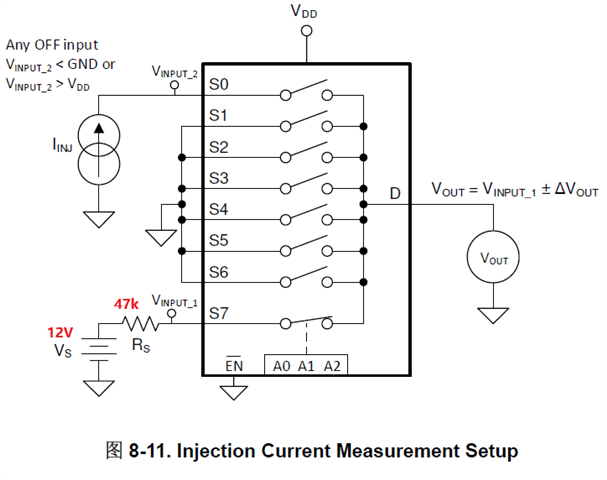

Hello team,
At the S7 input, there is a resistor of 47k connected to a voltage of Vs 12V. When switching from S6 to S7, how long does it take to achieve a stable VDD voltage value at the D port? Since there is no detailed internal structure diagram of the chip MUX1308, but I understand that the S7 switch has port impedance, and the port will also have capacitance, the output D pin should also have resistance and capacitance. Therefore, under the influence of these internal parameters, how long does it take to obtain a stable voltage value at the D pin?
BR,
Daniel
