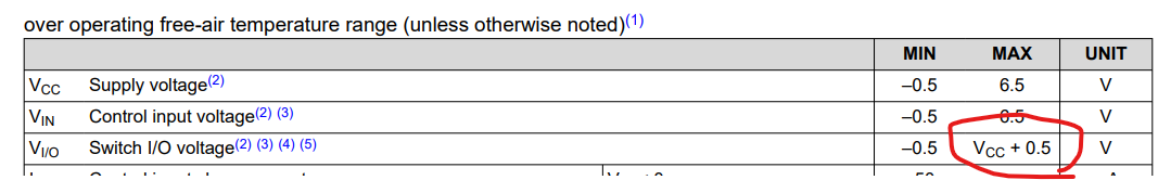

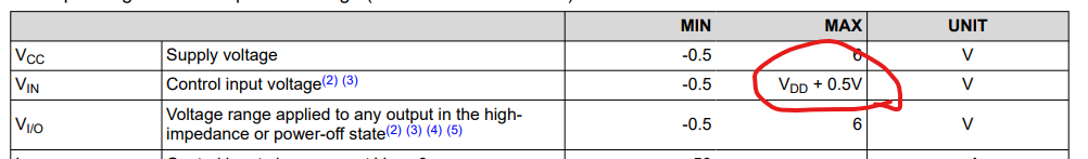

I found a change in absolute max rating value of Select pin (VIN) and VI/O pin in the datasheet.
Could you please double check if this change is correct?
  1. December 2021 SCES463H datasheet. power off protection is available for VIN only.
2. June 2025 SCES463I datasheet. power off protection is available for VI/O only.
regards,
  • That change indeed is wrong. The Revision History says "Changed ABS max VCC and VI/O voltage", and this description is correct, i.e.. only these two entries should have been changed.
    Apparently, the table was copied from some LVC logic device (which would have inputs and outputs, but not switch I/Os), and not all cells were adjusted correctly.
    The SN74LVC1G3157 (without -Q1) datasheet shows the correct values.
