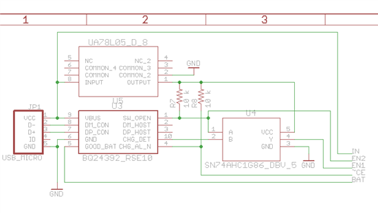

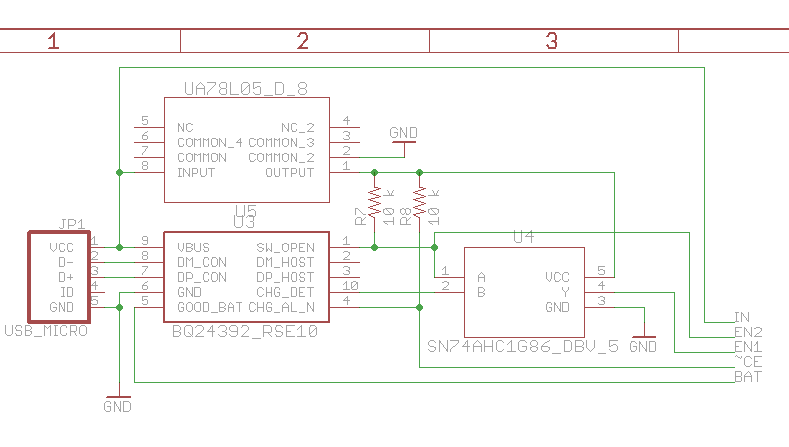

I am designing a charger application with a BQ24075. The source for charging the battery is a micro USB connector, and I would like to use a BQ24392 for setting the charge current by using the implementation of the USB battery charger specification v1.2 which the BQ24392 implements. I have been trying to find some application example of this type which uses the BQ24392 to no avail. Are there any examples available somewhere?
If not, could someone comment on the solution I have come up with? From what I understand from the datasheets, I need to set
BQ24075  -  BQ24392:
EN2  <-  SW_OPEN
EN1  <-  XOR(SW_OPEN,CHG_DET)
CE   <-   CHG_AL_N
BAT  -> GOOD_BAT
The schematics if have so far is the following, any hints if I am on the right way?
Thanx for any help!
  • Hello Claus,
    I suggest the following:
    • EN2: CHG_DET
    • EN1: AND(NOT CHG_DET, NOT SW_OPEN).  Or you can also: NOR(CHG_DET, SW_OPEN))
    • Also in typical applications CHG_AL_N is tied to VBUS.  This ensures that the charger does not start charging until the detection sequence has completed.
    This logic combination for EN1 and EN2 will allow you to use high current charging for every possible high current charger attachment.
    Andrew
  • Dear Andrew,
    thanks a lot for your answer, I don't quite catch it though. I'll copy the logic tables I have used. From BQ24075 we have for En1, En2
    En1 En2 current USB-dev
    0 0 100mA SDP
    0 1 500mA CDP
    1 0 adj=1.5A DCP
    1 1 <<100mA Standby
    On the other hand, from BQ24392 I get
    SW_OPEN CHG_DET Switch Charger present USB-dec
    0 0 conn no charger SDP
    1 1 discon charger DCP
    0 1 conn charger CDP
    1 0 discon no charger none/standby
    I have associated the corresponding USB devices in the last columns. Now if I apply your logic:
    SW_OPEN CHG_DET USB-dev EN1=!SW_ & ! CHG_ EN2=CHG_DET USB-dev
    0 0 SDP 1 0 DCP
    1 1 DCP 0 1 CDP
    0 1 CDP 0 1 CDP
    1 0 none 0 0 SDP
    USB-dev columns are not sound. However, when applying my logic I get:
    SW_OPEN CHG_DET USB-dev EN1=SW_ EN2=XOR(SW_ , CHG_) USB-dev
    0 0 SDP 0 0 SDP
    1 1 DCP 1 0 DCP
    0 1 CDP 0 1 CDP
    1 0 none 1 1 Standby
    (this is how I arrived at the circuit) What am I missing here?
    Kind regards, Claus
  • Hello Claus,
    I think you have the EN pins for the BQ24075 mixed up in the above.  Here is the table from the datasheet:
    Explanation of my implementation for your design:
    If you tie EN2 to CHG_DET it will mirror the BQ24075 logic table.  For both 100 mA and 500 mA charging case it will be low and for 1.5 A it will be high (I view Standby as don’t care because the charger will be disabled by CHG_AL_N in this case).  Also a CDP can be up to 5A according to BC1.2 specifications and a SDP can be up to 500 mA.
    Now we need to create the logic to mimic the BQ24075 EN1 logic.
    I have come up with the table below. To get 500 mA from an SDP I believe you need to negotiate with the host for it per USB spec so the SW_OPEN pin must be active to do this communication(i.e. low or 0 in this case). Then if you want to utilize a CDP as a high current charger the SW_OPEN output can be high-z or low depending on GOOD_BAT.
    CHG_DET
    SW_OPEN
    EN1
    USB-dev
    Current
    0
    1
    0
    SDP (low)
    100 mA
    0
    0
    1
    SDP(high)
    500 mA
    1
    1 or 0
    0
    CDP/DCP
    1.5 A
    X
    X
    1
    Standby
    none
    Using a EN1 = !( CHG_DET or SWOPEN) will yield the following table which matches the above:
    EN1
    USB-dev
    Current
    0
    SDP (low)
    100 mA
    1
    SDP(high)
    500 mA
    0
    CDP/DCP
    1.5 A
    0 (X)
    Standby
    none
    Does this make sense?  Of course you can choose not to use the CDP as a high current charger in which case your implementation will work perfectly.
    Andrew
  • Dear Andrew,
    thanks for your detailed answer! I think I understand that it is better to have CDP mapped to 1.5A,so both CDP and DCP can use the high current charger. With my logic CDP would charge only with 500mA.
    However, in the case of SDP, one should start with 100mA and then negotiate, i.e. in this case  I would expect CHG_DET=0 and SW_OPEN=0 from the BQ24392 side. One would then have to set EN1 depending on the negotiation, but CHG_DET and SW_OPEN should stay low, shouldn't they? How could SW_OPEN be 1 for SDP (low) and 0 for SDP (high)??
    This would certainly be interesting for an AN, it is not so easy to derive...
    Kind regards, Claus
  • Hello Claus,
    My thoughts on this were that if GOOD_BAT is low during an SDP attach(and stayed low) then SW_OPEN will be high-z and the USB switches open.  Then you couldn't negotiate for the higher current 500 mA.  If GOOD_BAT is high then the SW_OPEN pin will be low, the switches closed, and you can negotiate for the 500 mA.
    I am not 100% sure how your system is handling this but this was my assumption.
    Andrew
  • OK, so you had in mind the battery failure case. So let me summarize, if I finally have got it.
    EN2=CHG_DET.
    GOOD_BAT=HIGH:
    EN1=0 (only set EN1=1 if 500mA negotiaition succesfull)
    because with a working battery we would have SW_OPEN=0, EN1=0 in the SDP case for 100mA. This would actually mean to set EN1=0 all the time, with the exception of the case of a sucessful 500mA negotioation, which would set EN1=HIGH (for CHG_DET=1 no negotiation woud be initiated and can thus not be sucessfull).
    CHG_DET
    SW_OPEN
    EN1
    USB-dev
    Current
    0
    0
    0/1
    SDP (low/high)
    100/500 mA
    1
    0/1
    0
    CDP/DCP
    1.5 A
    X
    X
    0
    Standby
    none
    Or did I miss something again? Thanx for your patience, Andrew!
  • Hello Clause,
    This looks good to me.  I'm glad I could help, let me know if you have any other questions or concerns.
    Andrew
