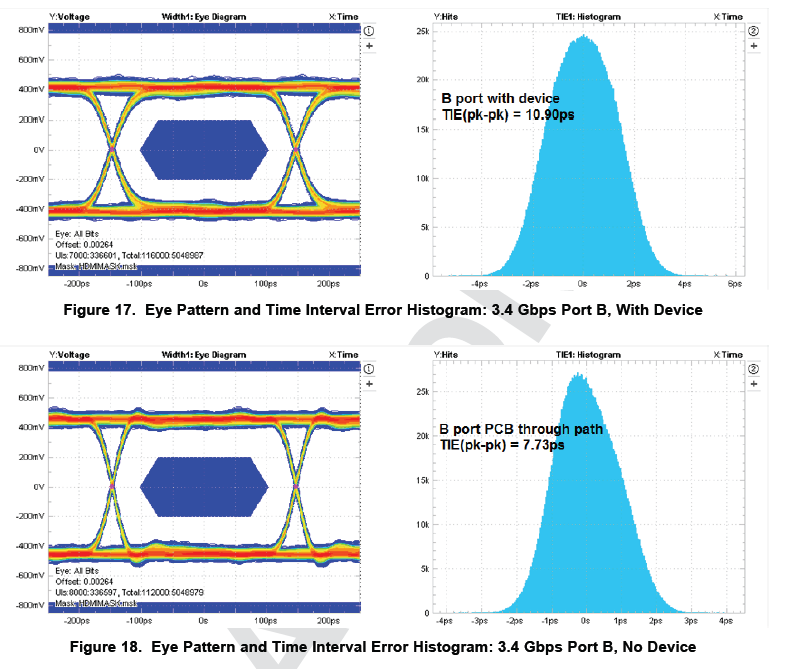

My customer wants the following information.
Could you please tell us the following question.
1.Can it support a signal of 4k2k30p (3Gbps)?
2. Did you measure the eye pattern at signal of 4k2k60p(3Gbps)?
3. Did you measure the max dissipation power at signal of 4k2k60p(3Gbps)?
Kanemaru
  • Hello Kanemaru-san,
    1.  Yes
    2.  4k2k60p is not possible with HDMI 1.4.  But we did measure the 3.4 Gbps eye for 4k2k30p.
    3.  As this is a passive switch,  the signal speed through the device has no impact on our devices power consumption (ICC).  If you are asking about the power dissipated through the switches of the device because of the current running through the switches then no we did not.
    Andrew
  • Hi, Andrew
    Thank you for your prompt reply.
    Could you please send us ”the 3.4 Gbps eye pattern for 4k2k30p".
    Kanemaru
    Here is the eye diagram
    Andrew

  • Hi, Andrew
    the "device" is the HDMI sink device(Display port connector etc…)?
    Could you please tell us the difference "with device" and "no device".
    And, could you please tell us the measurement environment of the eye pattern.
    Here's the setups:
    1. With Device
    Signal Generator -> TS3DV642 -> High Speed Scope with HDMI terminations
    2. Without Device
    Signal Generator -> Through path of high speed board -> High Speed Scope with HDMI terminations
    As you can see the diagram are very similar, showing how little the TS3DV642 impacts the signal passing through.
    Andrew
