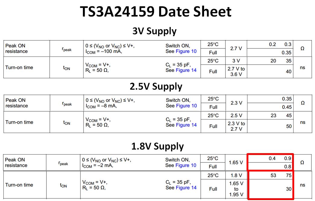

I would like to ask you the value of "Peak on resistance" and "Turn-on time”  for TS3A24159 Date Sheet.
The value of "Peak on resistance" and "Turn-on time” under 1.8V Supply are value@Ta=25℃ < value@Ta=Full for TS3A24157 Date Sheet.
But the value of "Peak on resistance" and "Turn-on time” under 1.8V Supply are value@Ta=25℃ > value@Ta=Full for TS3A24159 Date Sheet.
Could I have you confirm whether these values are correct?
