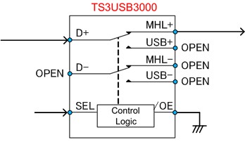

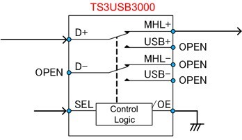

Hi Team,
Our customer is considering to use TS3USB3000. Below is the simple schematic.
Customer will only use the positive side of the signal pin.
They are concerning the output noise on MHL+ when switching from MHL+ to USB+, using SEL pin. (Switching signal OFF)
Could you please give us your opinion ?
If you have a measurement data, we appreciate if you could share us.
