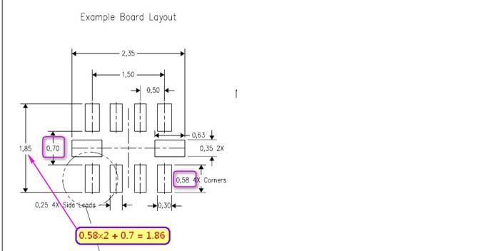

Customer would like to confirm:
1. the difference between TS3USB3000 and TS3USB3000M.
They seems to be same device with same package, only differ in tape and reel dimension, but the top side marking is different. So we would like to confirm.
2. The land pattern dimension for RSE package.
As below the dimension does not match, 0.58x2+0.7=1.86, not 1.85, please help to check
Thanks!
Sam
  • Hi Sam,
    1. Yes, you are correct. The parts are oriented in a different direction in the tape and reel.
    2. The 0.58 is actually 0.575, but rounded up because we do not guarantee accuracy of those measurements to three decimal places.
  • Hi Ryan,
    Since customer factory side must need spec as a back up for the dimension, for this case they need us to modify the spec, can we support?
    Or can we release offical document(or even e-mail) to claim the dimension was actually 0.575?
    Thanks!
