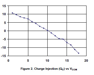

Fig 2 of TS5A9411 shows Charge Injection versus Vcom. But the figure shows Vcom extending to about 18V; but the absolute max for Vcom is 6V.
Is this the correct figure for this part?
Is one or more axis labeled incorrectly?

Hi Paul,
The x-axis should go from 0 V to 5 V. The data were taken at increments of 0.3 V up to 4.8 V with another sample at 5.0 V.
So the points should correspond to the x-axis at (0 V, 0.3 V, 0.6 V, 0.9 V .... 4.2 V, 4.5 V, 4.8 V, 5 V).
Thank you for pointing this out.
