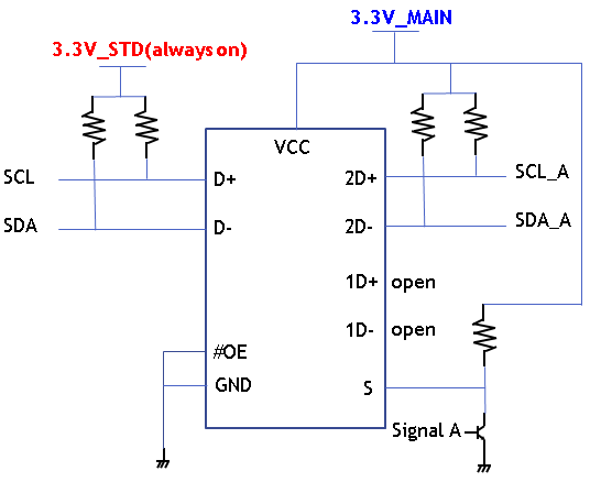

Hi Team,
My customer would like to use TS3USB221A for following application.
In his application, the power of 3.3V_STD is always on and 3V_MAIN could be powered off..
So, I'd like to ask two questions.
(1)
My customer concerns about the state of D+/D- when 3V_MAIN is off.
Could D+/D- be Hi-Z if VCC is powered off?
Is there any concern about this usage?
(2)
My customer assumes to disconnect SCL_A/SDA_A when signal A is supplied "H"(S="L").
Is it possible 1D+/1D- to be open as schematic above?
I concern if 1D+/1D- need pull up resistor or not.
