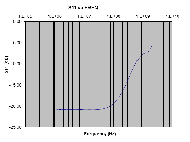

    4)  How high can I count on the Impedance at 480MHz to be at the INA when deactive, while INB is active?
    The RF impedance at off-state gives information about the reflection characteristics of the port. We usually characterize the reflection characteristics using the switch S11.
     The S11 at 480 MHz is -11 dB. The graph below is the S11 for path A when the switch is OFF.
