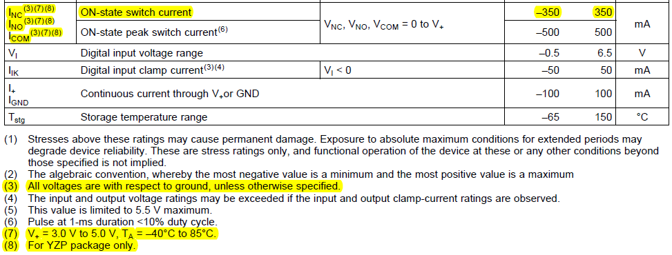

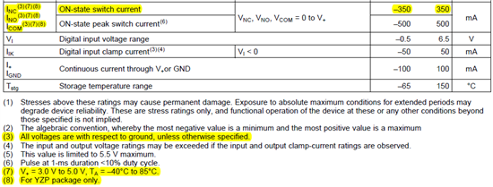

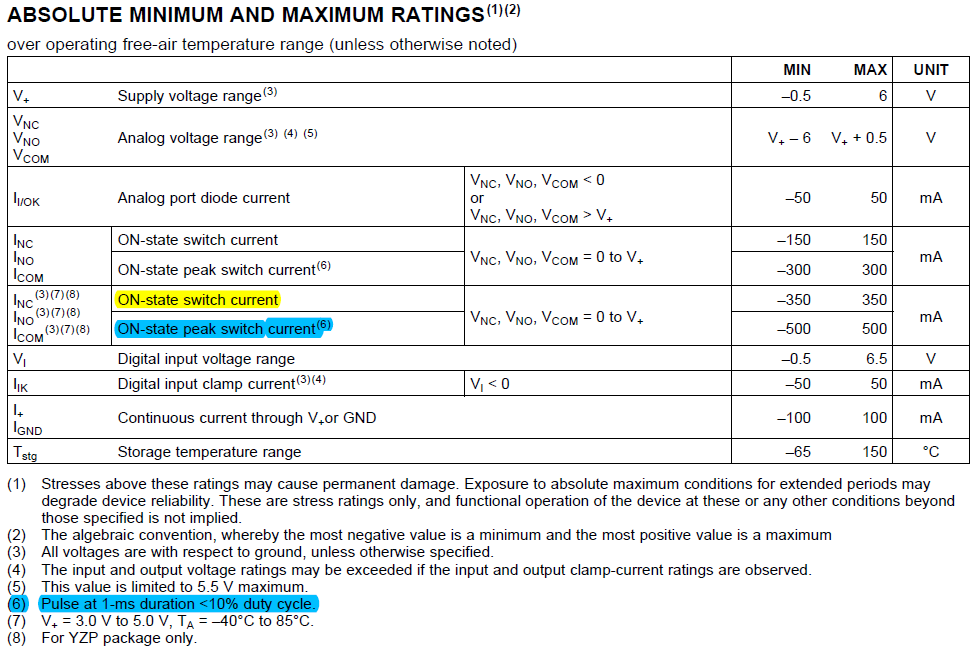

Hi Team,
We understood that the YZP PKG can tolerate ON-state switch current = +/- 350mA at V+=3.0V to 5.0V , TA=-40℃ to 85℃.
However, our customer are studying TS5A22364 at the following conditions.
<condition>
-V+=5.2V
- ON-state switch current(INC , INO , ICOM) = up to 300mA
So, can this device tolerate the up to 300mA at V+=5.2V?
And, could you please let us know the max value of this current at V+=5.2V?
