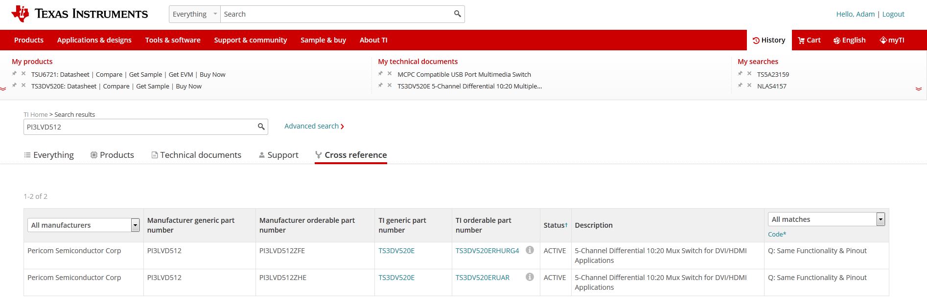

Could TS3DV520E support 24bit LVDS function as below figure " High Speed Passive switch
I think PI3LVD512ZFE is the same with TS3DV520E ,Is it right
  • Yes,  TS3DV520E support 24bit LVDS function as below figure " High Speed Passive switch and PI3LVD512ZFE is the same with TS3DV520E.  You can see this by our competitor cross reference tool on TI.com.  I have also included a more detailed comparison.
