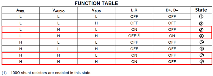

Hi Team,
Our customer would like to know about internal 100kohm shunt resistor.
[Q1]
I’m understanding that this resistors are enabled in ③,④,⑦,⑧ state.
Is my understanding correct?

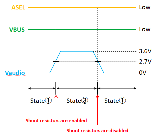

[Q2]
They would like to know the timing to connect this resistors.
My understanding is as follows.

    I've verified with design that the shunt resistors are enabled when D+/D- (USB) are on, and the L/R (audio) are off. In the table that you supplied, that would correspond to state 4.
    This makes your graph in [Q2] Incorrect, because it only shows the shunt resistors active in state 3..
    The main take away here is that the shunt resistors are enabled when Audio (L,R) is Off and USB (D+,D-) is on. The table in the datasheet does not list every possible combination.
