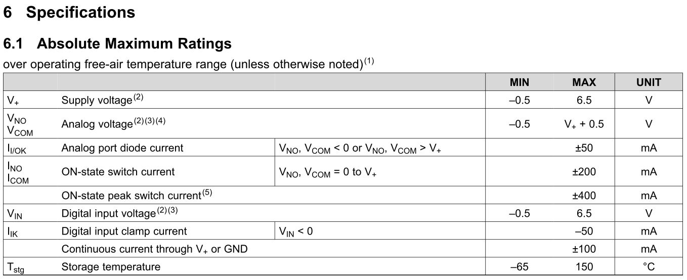

Hello Team,
Please allow me to ask you the absolute maximum rating for TS5A3159 NC pin.
I believe it is the same with V_NO, however, please let me confirm.
