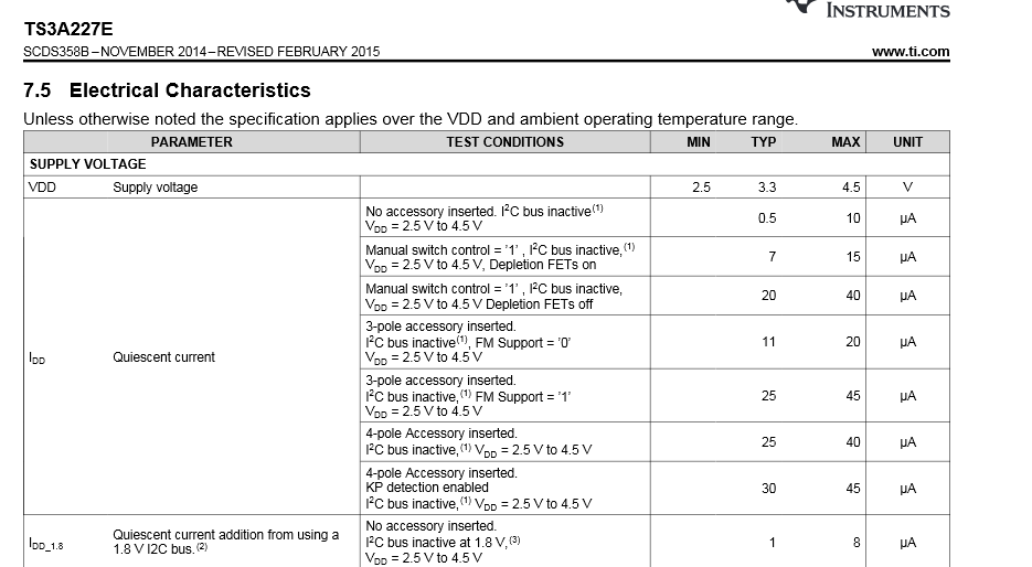

May I know the maximum power consumption for TS3A227E and I saw the maximum IDD,q is 45uA in the datasheet. Is it 45uA? Or what is the worst case?

    As you mentioned above the datasheet states the TS3A227E has a maximum IDD of 45uA when a 3-pole accessory is inserted, I2C bus is inactive, and FM support is equal to '1', while Vdd is 2.5V to 4.5 V.  The maximum value of 45uA comes when the ambient temperature is 85 deg C.
