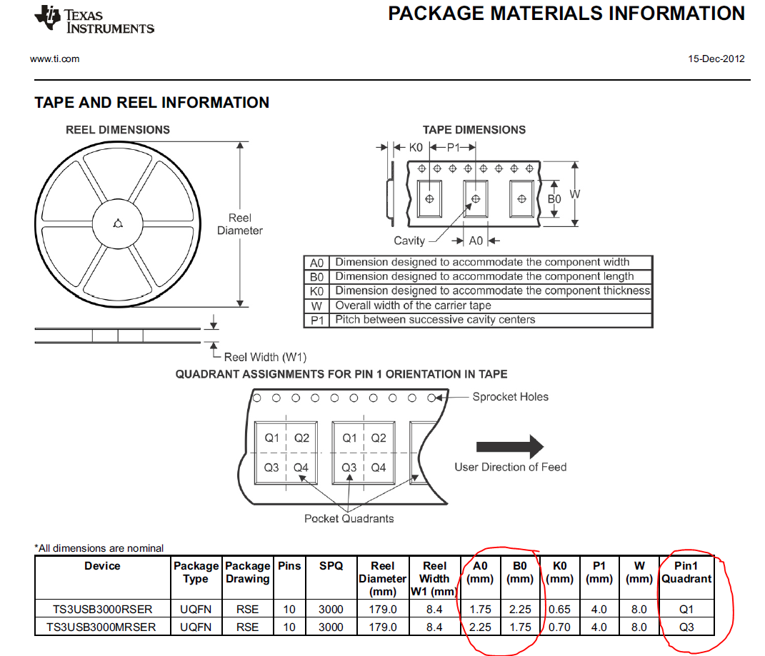

What is the difference from TS3USB3000RSER and TS3USB3000MRSER?
Other Parts Discussed in Thread: TS3USB3000
  • Josh,
    The difference in difference from TS3USB3000RSER  and TS3USB3000MRSER is the tape and reel information.  These two part numbers are for the same IC and package but the M signifies the difference in the way the IC is placed on the tape and reel.
