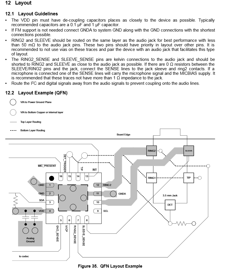

Could someone help to clarify TS3A225E audio crosstalk issue as below,
When sleeve or Ring2 signal through FET2 or FET1 connects to GND, audio crosstalk is 53dB.
When sleeve or Ring2 signal connects to GND directly, audio crosstalk is 70dB.
Can help provide the layout guideline and crosstalk limitation of TS3A225E to me?
Thanks for your help.
  • Jacky,
    To help my understanding of your test do you have a diagram of your test set up and screen shots?
    The TS3A225E has the isolation and channel separation characteristics state in the datasheet below.
    If you look at the bottom of our newer audio jack switch TS3A227E datasheet you can see a section with layout guidelines and layout examples on pages 48 and 49.
