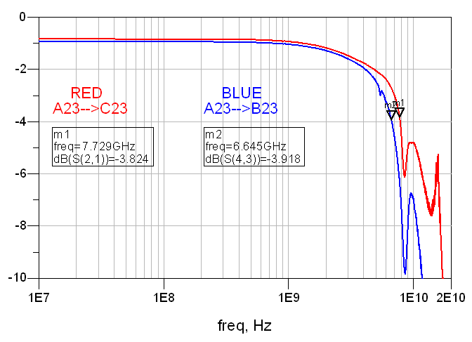

    A S-parameter model is always preferred when simulating these high speed switches because an IBIS model simplifies the circuit down to an ideal input stage with a buffered output stage which really offers no information on high speed performance.
    I have attached measured data from the TS3DV642. Each of these is a 4 port network with the following port configuration: http://e2e.ti.com/cfs-file.ashx/__key/communityserver-discussions-components-files/388/3755.TS3DV642_5F00_ComtoA.s4phttp://e2e.ti.com/cfs-file.ashx/__key/communityserver-discussions-components-files/388/5672.TS3DV642_5F00_ComtoB.s4p
    Port 1: D1+
    Port 3: D1-
    Port 2: D1A+ or D1B+
    Port 4: D1A- or D1B-
    I have also attached the Sdd21 plot for each model to verify the configuration prior to simulation
    Thank you,
    Adam
