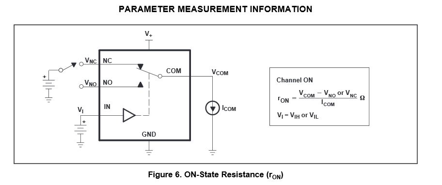

At 25C, the datasheet says that the Rdson could move around by several Ohms from part to part. The max Rdson at 25C is 9 Ohms, and then at 85C is 10 Ohms:
One can extrapolate from this that temperature will only affect the Rdson by no more than 1Ohm from its 25C starting place.
Some testing of a couple parts by the customer yielded a similar result:
Testing of a few units shows just under a 1Ohm increase from 25C to 85C. Have you guys seen this trend hold across multiple test lots?
