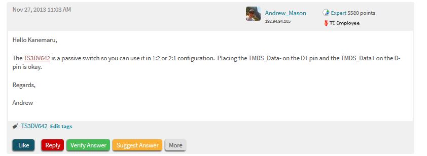

   We are using the TS3DV642 device as a switch between two HDMI interfaces. I
1. In that case is it must that we should route the clock signal to D0+ and D0- pairs itself?
2. Can we route the TMDS data pairs considering layout easiness to any of the D1/D3 lanes.
3. Can we route the TMDS+ to D1- and vice versa?
