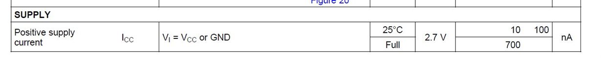

using the TS3A24159YZPR device in my design and I have a question regarding it's current consumption:
During regular tests I noticed that the device current consumption is by far larger than expected (I performed measurements at 2 devices).
At 25deg I measured 145nA and 147nA.
At 80deg I measured 1.966uA and 2.028uA.
After I noticed that current consumption is larger than expected I made sure that no other device is related to that current consumption by disconnecting series resistors. follwing are the results:

    The data you provided appears to be higher current consumption we expect with a 2.7 V supply according to the datasheet.  We do expect the current consumption to increase with temperature as you show but we shouldn't see it going over 100nA at 25 deg C.  I have looked at some of our historical  characterization data and it looks well within spec of 700nA across temperature.
    What are your input logic pin Voltage when taking your data?
    How many units are you seeing this higher current consumption?

    1)I did a quick bench set up to test the Icc spec per the datasheet to get a baseline for my proceedings. With Vcc= 3.3V and all other pins open I recorded Icc = 16 nA.
    2) I tried to duplicate your set up
    IN2, NC2, NO2 = GND
    COM2 = open
    IN1, NC1 = GND
    NO1 = VCC through 10K resistor pull up
    I measured 252nA in this configuration.  This is saying to me that there are leakage paths from Vcc to ground through the internal switches.  If you leave the switches open there is no leakage path for the Vcc to ground through the internal switches.
    3) I tried to create the most leakage I could from Vcc to GND by grounding all the signal paths and was able to get Icc up to 272nA.
    4) I proved this leakage concept to myself by setting Vcc= 3.3V, IN1/2 = 0V, and left NC1/2 NO1/2 signal paths floating.  I toggled COM1/2 from 3.3V to 0V.
    If COM1/2 = 0V, Icc = 229nA
    If COM 1/2 = 3.3V, Icc = 14nA
    This tells me that the potential difference across the internal switches from Vcc to GND can cause some leakage.
    Let me know if this explains what you are seeing in your testing.

  • After some further investigation it appears that the extra current consumption is drawn from NO1 pin which is connected to the VCC pin through a 10K resistor.
    After discovering this I made some further tests as described below:
    VCC = 2.75V
    Vin = GND
    V_COM = open
    V_NC = GND
    Voltage at NO1 pin was supllied by a separated  external supply while monitoring the current into this pin.
    NO1 voltage was increased and the input current to that pin was monitored.
    I found out that as long as the NO1 voltage is 2.6V or less, the NO1 leakage current is more or less constant (below 30nA).
    As the voltage approached 2.7V the current dramatically increased and when the NO1 voltage was 2.75V (same as VCC) the leakage current approaced 110nA.
    I got similar results regardless the IN input status (GND or VCC).
    The Vcc current during these tests was also monitored and was stable (7nA - 9nA).
    At 80deg the behaviour was similar but the currents were much higher (455nA at V_NO1=1V, 573nA at V_NO1=2.4V, 922nA at V_NO1=2.7V, 2.2uA at V_NO1=2.75V).
    I noticed that in datasheet the leakage current is given for V_NO or V_NC equal or less than 2.2V; is there a special reason for that?
    What is the cause of this dramatic increase of the leakage current when V_NO approaches VCC?
    Based on your experiments it sounds like the behavior is expected since the device is operating within the datasheet limits so I have put in a request to the design team to identify and explain the leakage mechanism that causes the increase in leakage as the input/output signal gets close to the supply.
