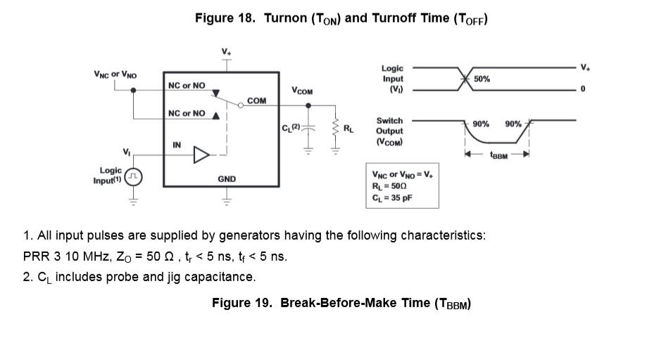

  • Steve,
    Could you draw a picture of the connection you are asking?  Sorry I'm not clear on your question.
    The break before make time specification for this device is from the time that NO FET will begin to turn off (90% of its final voltage) until the NC FET will turn on (90% of its final voltage.)

    By the way, there is an anomaly in the parametric search for analog switches.  The TS5A23159 is shown with a max on-delay of 55ns, while the data sheet shows 16.5ns max for 4.5-5.5V.  The 55ns figure is for low voltage operation, so it makes this switch difficult to find if you're looking for a fast 5V switch.  Ron also shows up as 15 ohms.  I tried to attached a screen shot, but the browser is crashing when I do (Firefox on Ubuntu).

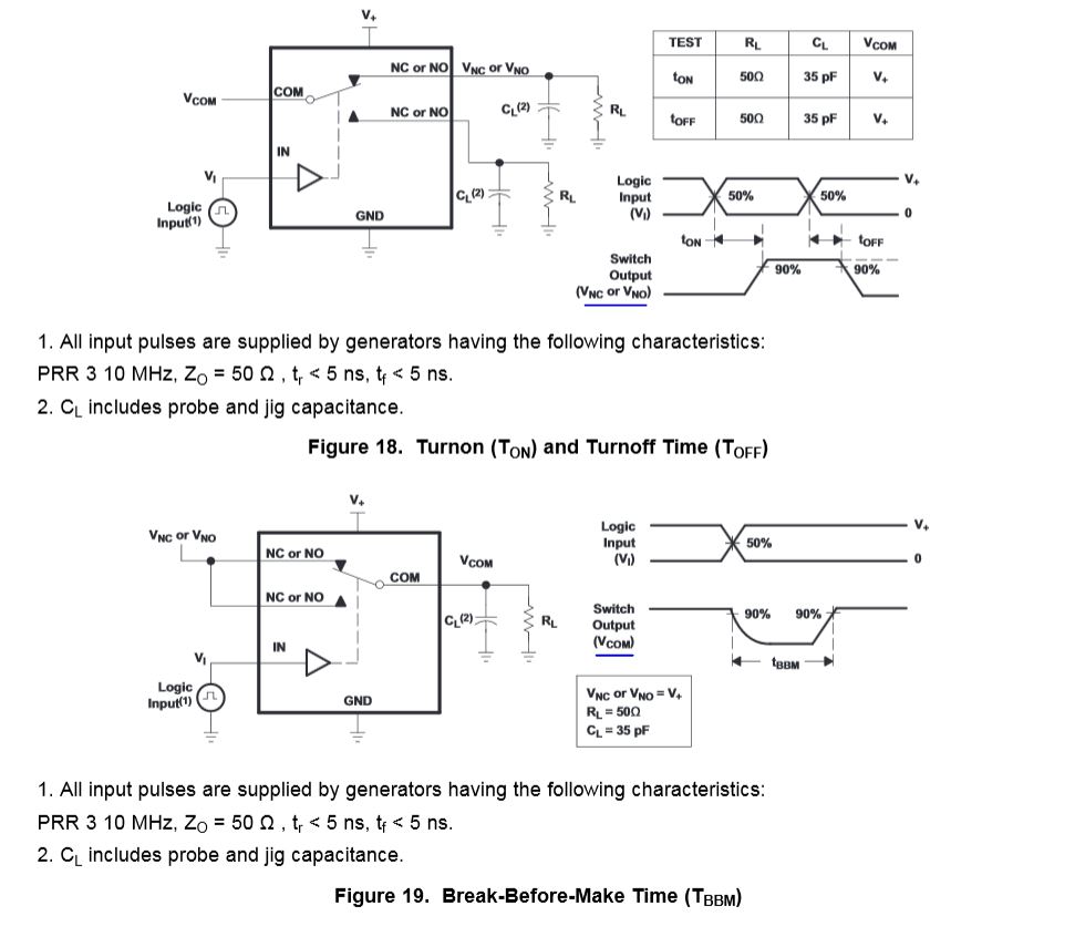

    Another question:
    The TS5A23159 data sheet for 4.5-5.5V operation shows the min "tOFF" as 1ns and min "tBBM" as 1ns.  The min "tON" is also shown as 1ns, but it seems to me that the following inequality must be observed for a SPDT switch:  tON > tOFF+tBBM  Could you clarify this please?

    Here is some insight on how the table kinda works that might help your understanding.  In general if there is a typical value in the table it will state the value under the best test conditions usually 25deg C.  If there is a max value it will be the value under the worst test conditions usually 85 deg C.  If you are looking for low Ron I would filter on Ron typ which will give you values under good test conditions instead of Ron max which will give you wost test conditions.  Having the typical (being good values) and max (being bad values) we tried to accommodate customers designing for typical and wost case corners.  We are always open to suggestions on how to make this better.
    To answer your timing question you need to look at how these timing values are measured.  The Ton and Toff specs are measured with a voltage (V+) placed on the COM pin and then measured how long it takes the NC and NO pins to reach 90% of (V+) after the IN pins transition.  The break before make is measured with a voltage (V+) placed on the NC and NO pins and shows how long of a time the COM pin voltage stays below 90% V+ after the IN pins transition.
