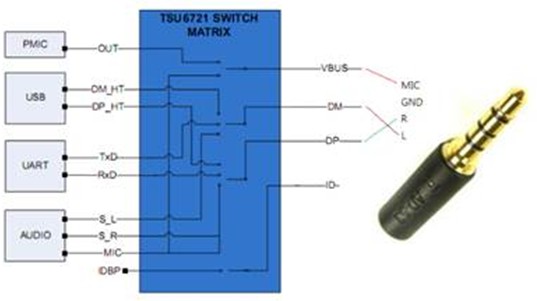

Can TSU6721 support charge by audio jack?
Other Parts Discussed in Thread: TSU6721
My customer now survey an application that charge by audio jack.
Can TSU6721 achieve this application? Are there any other suggestion for this?
Below picture is what I though:
  • Daniel,
    The TSU6721 is a highly integrated device that may be overkill for your application.
    Can you help me have a better understanding of your application so we can find a better solution?
    1) Describe the type of device are you making?
    2) Can you send the datasheet of the charger you would like to support?
    Thank you,
    Adam
