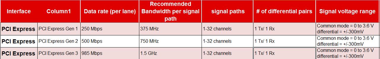

    To evaluate if a signal switch like the HD3SS3411 can support a particular signal standard (like PCIe Gen1) you need to look at the number of channels needed, data rate/ bandwidth, and voltage range of the signal.  Below is some information on the different types of PCIe signals.
    The HD3SS3411 has the bandwidth to support PCIe gen 1 signals and can support the common PCIe voltage range.  The HD3SS3411 is only a single lane device so I would check how many of these switches would be needed.
    If you need multiple channel devices I would look at the TS3DDR4000 (12 channels) or the TS2PCIE412 (8 channels)
