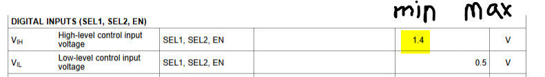

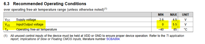

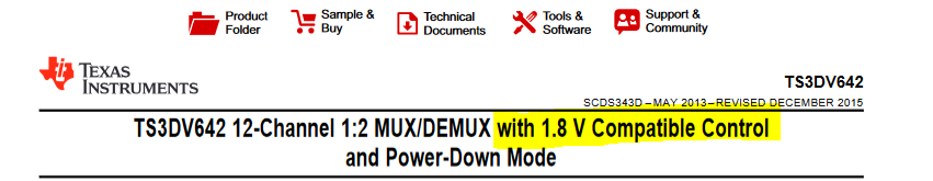

I needed a 12 channel 2:1 Multiplexer for selecting between two different BT.656 video signals(8 bit data+ 1 clock) among which one is to be directed to the OLED display at a time.
The signals are CMOS 3.3V compatible.
I would like to to satisfy my requirement consuming minimum space(so probably single chip).
Can I use the part# TS3DV642A0RUAR for it?
