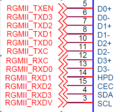

  1. Can I use this part for muxing RGMII MAC signals?(TXC,TXD[3..0],TX_CTL etc)?
  2. If not, can you suggest some other part which would fit for the above application?

    Yes, TS3DV642 12-Channel 1:2 MUX/DEMUX is recommended for General Purpose High-Speed Signal Switching.  To evaluate if a switch is suitable for a particular protocol like RGMII you need to look at the datarate/bandwidth, voltage swing, and number of channels.
    For RGMII I believe the answers to those questions are in the table below.  The TS3DV642 has plenty of bandwidth (>7GHz), sufficient number of channels (12),  and recommended signal swing on the data lines be within 0-5.5 V.

    I had some doubts with respect to pins HPD,CEC,SDA and SCL of TS3DV642A0RUAR. Can I use these pins also and connect to  LVCMOS RGMII signals.
    eg:
    HPD---------RGMII_RXD1
    CEC---------RGMII_RXD2
    SDA---------RGMII_RXD3
    SCL---------RGMII_RXDV

    What is your doubt with respect to pins HPD,CEC,SDA and SCL of TS3DV642A0RUAR LVCMOS RGMII signals?
    All of the signal paths in the TS3DV642 are the same since the datasheet does not have different specs for different signal paths.
