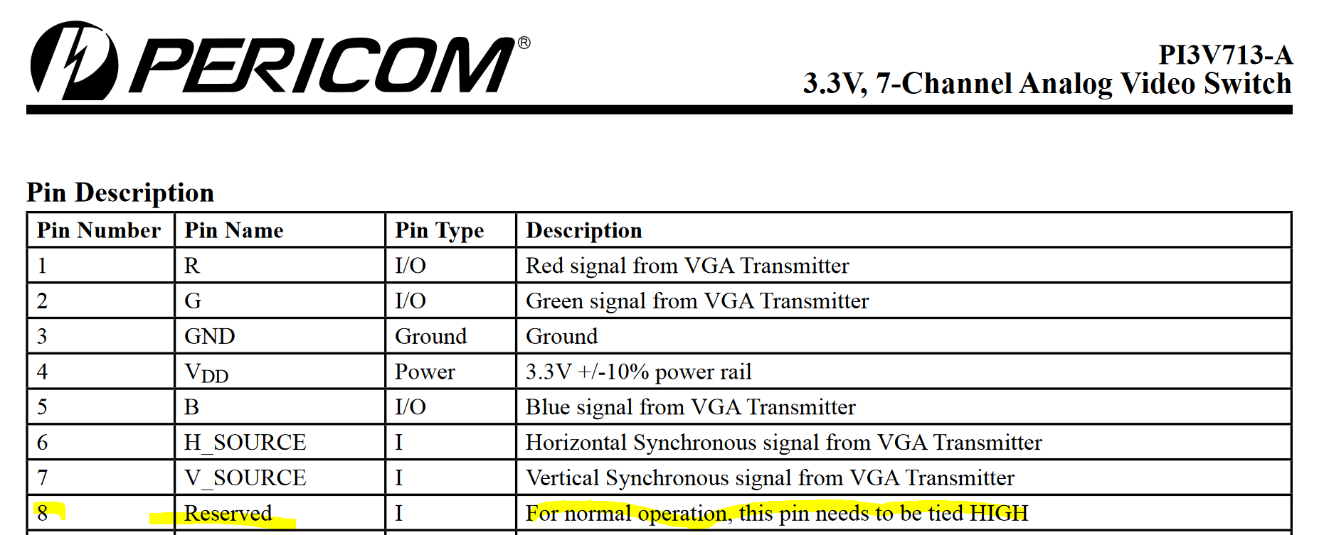

Adam,
Competitor's device is pin2pin with TS3V713EL, and the pin8 is required pulled up to 3.3V. Customer would like to use the same BOM and connection.
Since pin 8 does not have a bond wire connecting the pin to the internal silicon, is there any risk and other consideration to connect pin8 to 3.3V?
Thanks.
Johnny
Johnny,
I pulled the PI3V713-A datasheet from pericom's website and see that for the PI3V713-A device you are correct you need to pull up pin 8 Reserved pin "high".
Since the TS3V713EL does not have a bond wire connecting pin 8 to the silicon there you may apply 3.3V to pin 8 without issue.
