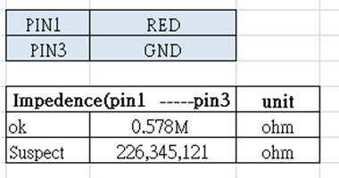

My customer find in ICT detect this part failed due to low impedance compare with good unit, but we didn't find the impedance control spec in datasheet, could you advice if the low impedance can be accept or not?

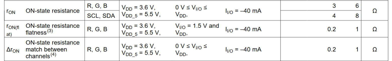

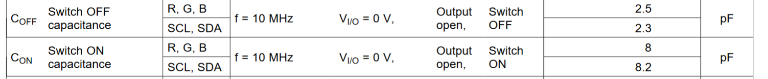

    The impedance of the signal path of the TS3V713EL can be found in the datasheet called on-state resistance (ron) and on-state capacitance (con/coff).
    You can also use this thread to see how to calculate the impedance of the switch when the device is off.
    Thanks for the response but I don't know how to link your reply to customer measurement result as below that they measure on a failed IC to a good IC (not on a failed system with a good system)

    Pin 1 of the TS3V713EL is a signal path and pin 3 is ground.  How is the customer measuring the impedance on these pins?
    The impedance from pin 1 to pin 27 will change depending if the signal path is on or off.
    How did the customer know they have a problem and decided to look at the impedance on two different ICs?

    Normally customer wil have a test station to measure all the ball impedance is normal or not.  Usually they'll define the normal value range based on the statistics number based on the impedance value they measured from some amount of the boards.
    For the queston they're asking now, they caught these chips from the test station mentioned above which they found the value is different from other chips.  But, actually they didn't encounter any application issues with these chips.  They just want to make sure if these impedance is still in normal range or not.
    The impedace measurement value I provided earlier is using a multi-meter with chips already removed from the board.  Please let me know what else you need.
