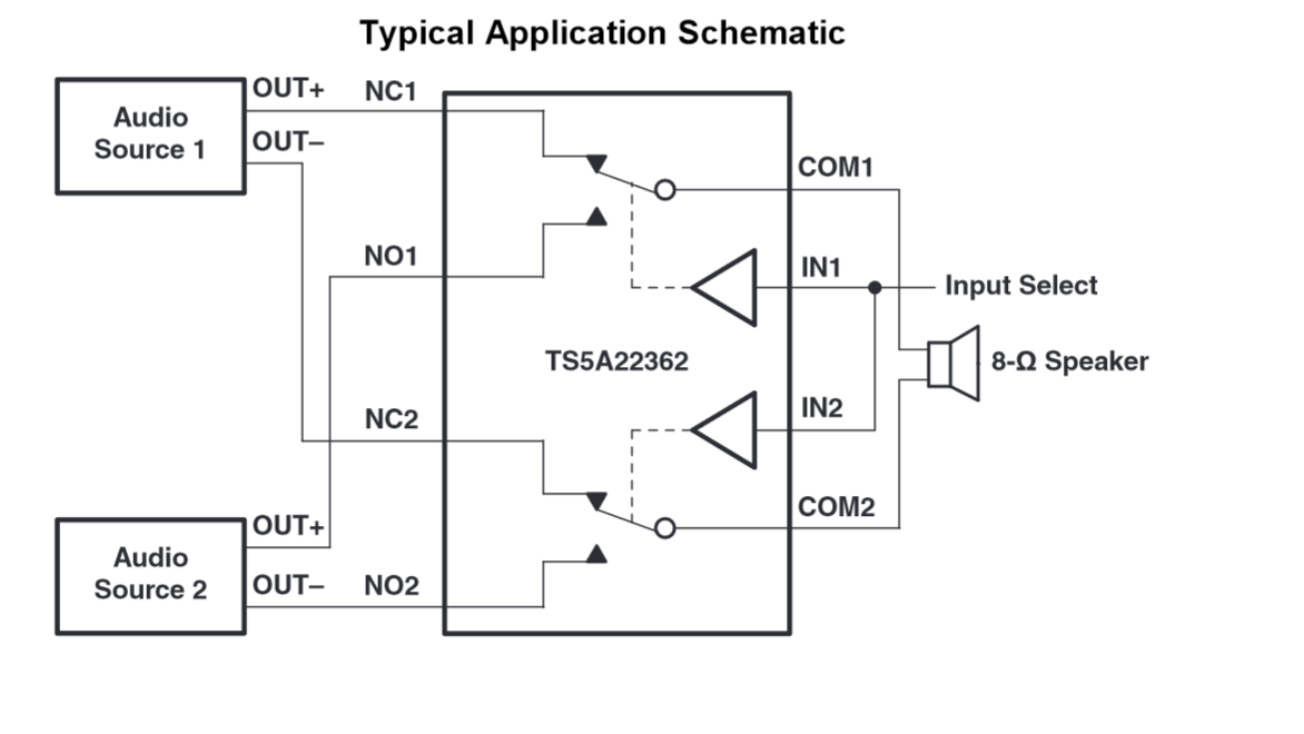

I want to select only one of two source of balanced audio. I'm using DRV135 with +/-15vdc power supply. Could you suggest me any analog multiplexer?
  • Samuel,
    We have several audio switches available.  To help get you started in your search I would look at the TS5A22362 device which can take .   This device is capable of supporting +/- 2.75 V with <1 ohm on-state resistance and low THD.  I'm not sure what type of audio device you are driving but I would imagine this switch would sit in front of your gain stage to your speaker.

  • Hi Adam,
    Audio sources are from dynamic microphones that previously are preamplified with INA217and then are converted in balanced audio with DRV135.
    Those signals should be selecting by MCU and mux. The selected audio signal is amplified by means professional audio amplifier equipment.
    Additional, I want a switch or mux with high impedance state when non amplified signal is requiered
    If dual source is used, Can I use signal control type TTL?

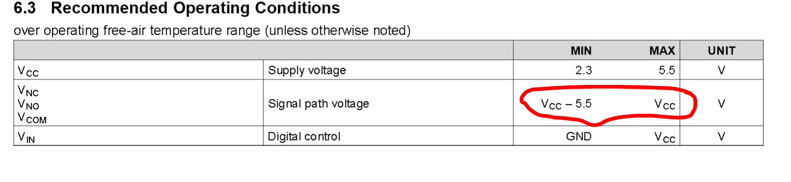

  • Adam,
    Datasheet says: The input and output signal swing of the device is dependant of the supply voltage VCC.
    Therefore, when audio signal is +/-2.5Vrms I must use a single 2.7VDC, Has it negative supply inside?
    How Can I protect switch input for the purpose of audio signal don't exceed the recommended operating conditions?
  • Samuel,
    Yes you are correct.  If you have an audio signal that is +/- 2.5 Vrms the supply voltage should be set to Vcc = 2.7 V DC to satisfy the recommended operating condition.  The device has a feature to handle the negative voltage without distorting the signal.
